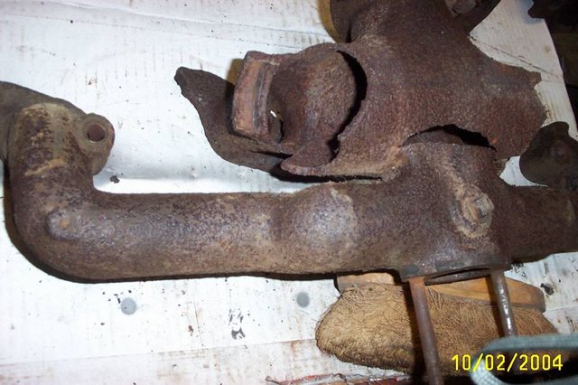

My '61 Farmall 560 has a cracked exhaust manifold. It's cracked right where the exhaust pipe connects to the manifold. That whole area needs a good bead to seal it back up. I'm running a MAC Tools WS1300 MIG welder. I've ground around the whole crack, and welded it and ground it off 3 times. Am I missing something here? Or am I really that lousy a welder? Do I need a special wire for the manifold? Is it cast iron?
Any tips or help will be greatly appreciated.

A mig welder will not work with any wire. Use a stick welder with small sized Ni-rod. groove the crack. Using a rose bud heating tip on your acytlene tanks, do not use welding tips, uniformly heat the entire manifold. Make sure and keep hot, may need a helper. Run a small short bead. Have a good sharp pointed peening hammer and peen. This removes the tension on the weld. May tack it to keep it aligned. KEEP IT HOT AND PEEN it after every run. it is slow work you cannot hurry. Make sure and KEEP IT HOT. have a pile of DRY sand when you are done bury it in the pile of DRY sand and forget till the next day. It is dificut but gives a lot of pride when you get done. GOOD LUCK

If you are welding with a mig welder, switch to stainless steel wire. Preat the manifold or anything cast with either a torch or put it in the bottom of a 55 gal. drum with a light amount of gas to warm it up. A propane torch will work ok in small areas and for short welds. The reason that the area keeps cracking out is that the cast is cooling at a faster rate than your weld will. Stainless or nickle is the only rods that you should use to weld cast iron unless you are using a torch, then brazing will work. If you chose to use the mig welder, you will want a Argon based sheilding gas to eliminate and porosity in your welds. You dont need the cast to turn cherry red during preheat but all you need is to have it about 300 degrees. Maybe your wife will allow you to use her oven... I have done that before as well. Good luck.

When you get tired of having more failures than successes with arc weld of any type , grab your o/a torch , some cast iron in stick form , a can of flux ,and learn to properly weld cast. Brazing is a reasonably good repair , but works best on items that don't change temperature much and manifolds don't fit that description very well. Your best repair is with o/a and cast rod . Below are 2 pictures , before and after repair with o/a . There is also a link to many more pictures of that repair .
The third image is a 1929 waukesha manifold, and yes it is repairable.
george
