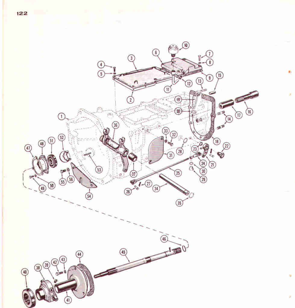

i have this 430 case( 1969 ) and i have this winning noise near the front of the transmission,the soound is worst when i start the engine and less noisy after it warmed up ,i guess this is the clutch bearing,in the operators manual they say to grease it, but how ??, nothing is said in the manual, anybody know something about this? Martin 42

Thanx For the Reminder ,Need to do mine here ,Should be done annually ,, Take Lose the side Plate , Jim

Martin,
Here another try of the photo?

Here a photo copy from parts book. There is an inspection door item #31 this is where I grease my 530. Mike

Wow!, a picture is really worth a thousand world, the thing is i never saw that door, it' right behind a steel post for my front loader i'm new to old tractor and i love it, it's so simple but when you dont know what you're looking for, you can search for very long , thank you again Mike in Mi....Martin42
