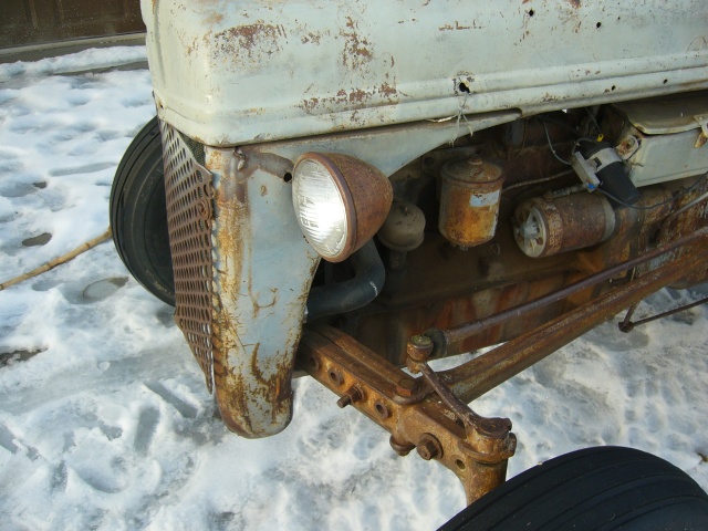

My 2N is a '42 by serial number on the block... however... it came with a smooth dogleg (one dogleg was missing) that I have read was chaged in '42 to the one with the lower bolt hole. Anybody have the scoop on this? And a smooth right side dogleg they want to get rid of?

It's not a 9N. As JMOR said, the I-beam radius rods lasted til 44. Since the smooth doglegs changed in '42, it's possible that mine came with some leftover smoothies during that model year before the new ones came out, or it's possible that someone just fitted one on.

Changes to bolt hole, 1942 and radius rod , 1944.

The reason your N has that style dogleg is because it is probably a 9N. I say this because the radius rods are the "I" beam type that were used on the 9 before they were changed to the hollow ovel on the 2n.

Whoops, that pic should be
third party image
Maybe a mod can fix that link and delete this post. Sure wish we could edit posts.
