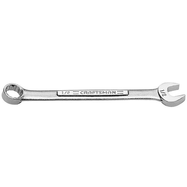

I will always have more questions. I have never adjusted a clutch or anything, but i'm not afraid to learn. I'll go out there this weekend and pull the plate off. If one of yall dont mind me calling if I have any questions please PM me your phone number. I live in the US, so I think my cell phone provider will kill my checkbook if I call wales.
Also correct me if i'm wrong but isnt a spanner just like a long box end wrench like this Link
[Log in to Reply]  [No Email]

Hi,
YEs, you need to use the open end.
No problem, drop me an e-mail and I won't be long getting back to you.
David
