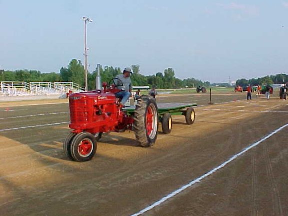

third party image
Let me ask you this. If you were to walk up to the wagon and bend over pick up the tounge, could you by hand steer the wagon? Probally so. I use to not be able to back a wagon until I realized that if I pretended that the drawbar was my hand, I had no problem backing and generaly place in the wagon backing compitition at our tractor rodeo.
