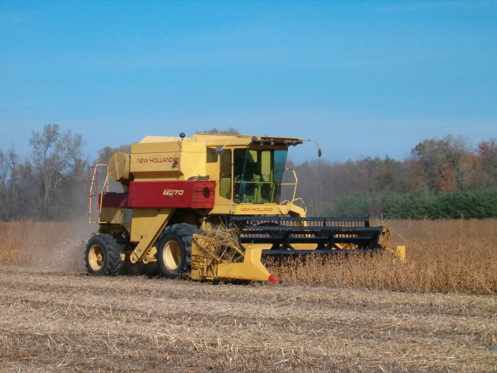

Well I was bored today, started looking through some pictures and found some from the first field I took off with my combine. Soybeans on my Grandparents place.
third party image
Running down the field.

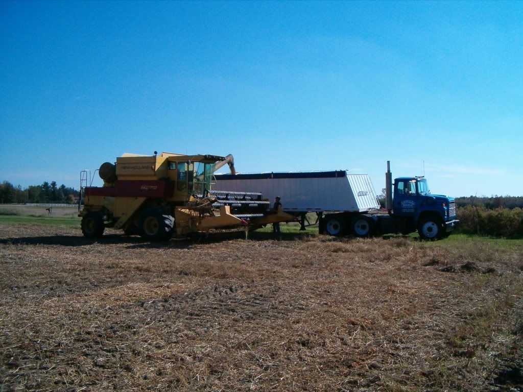

Dumping in the semi, pulling weeds off the head.

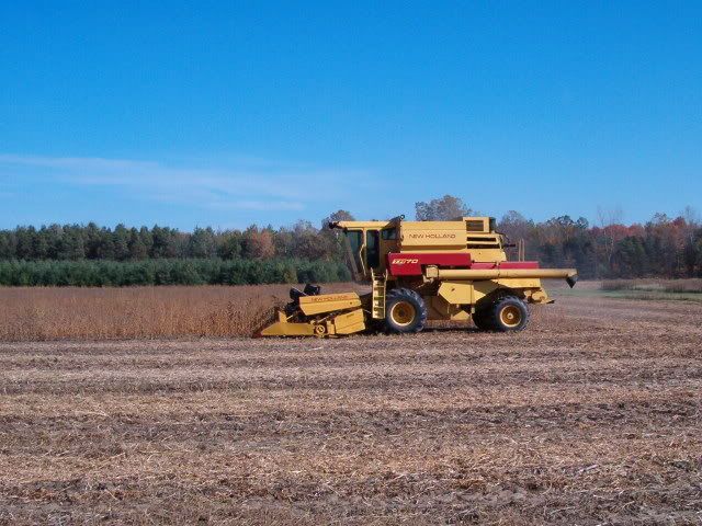

Heading back down the field.

So far I like the New Holland quite a bit. I know it’s not the perfect combine but it does a better job than the 6600 we had and has more capacity. No real major break downs so far, in the two years we’ve run it (1200 acres) the rotary screen on the radiator broke, the bearings started to go out on the main drive group sheave and the sensor switches on the grain table went bad. I don’t consider that anything major. It has the Cat 3208 on it for power, the only other one in the area was a TR75 with the 363-I6 on it and it was underpowered in my opinion when I ran it. But it’s easy to set up, easy to run. Mine has every option that you could get from the factory, which includes a power rock separator in the feederhouse. Unfortunately this only kicks out the big rocks because I have put one or two smaller ones through it but they don’t seem to hurt anything other than make a lot of noise. Dealers that have those things want the same price for them that they would get for a IH or a Deere of the same age and it just won’t do it. You don’t pay a lot for a NH to get one, but you won’t get anything out of it in the end either.
As for a combine with the separator and engine hours being 30 apart, one of the two is lying.

HPF, nice machine, I've ran a couple including an 85 best bean machine of thier time was a little concerned about rock protection but overall easy to operate a little noisey with that CAT motor but just turned up the radio. CT

That's a nice looking combine. Does it have the Cat 3208 V8 diesel, Ford 363 I-6 diesel, or the Ford 360 V8 gas? How does whatever engine that it's equiped with hold up? Any problems with the engine?

Nice pictures. How do you like that New Holland? Local dealer has one sitting on the lot, been there for years, has 3 heads with it, asking $10,000. A friend rented it one year and said it was down more than it was up. Guess thats why it still sitting there.
