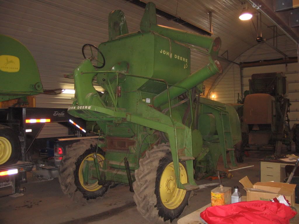

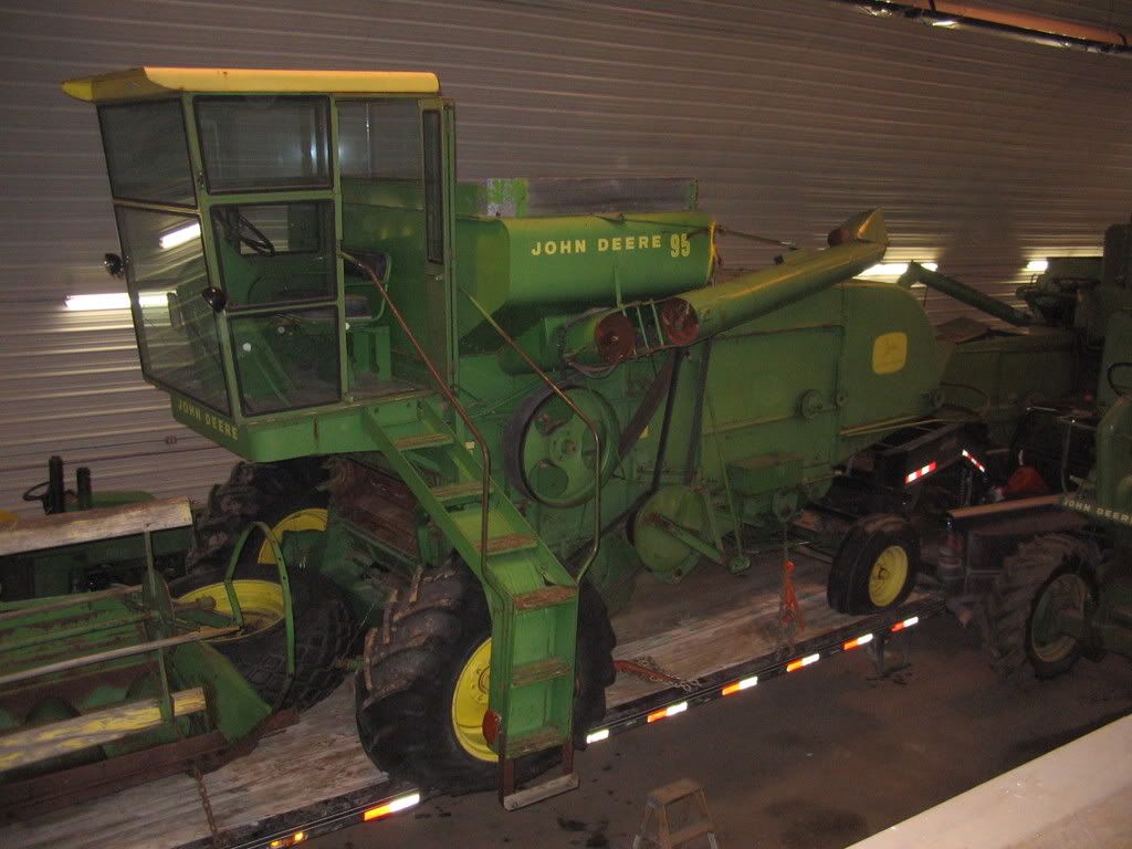

 45 and 95 augers in reply to Bradley K, 02-03-2008 11:50:06
Here's a 1958 45 with the old style folding and a 1963 95 HiLO folding to the back.
