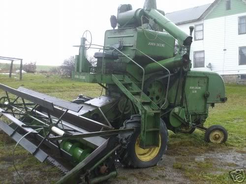

Check out this dandy older JD 55 on ebay.Always shedded and has one original drive tire.
Too bad its so far away.I wonder what it will bring?

This one appears to have the hydraulic variable speed, not available on the earlier models.

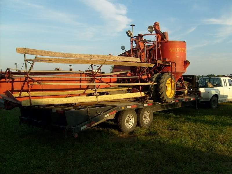

Yes, looks like a nice machine. It's only 200 miles from me and the auction ends on my birthday. Is that a sign? I'd still have to convince my wife. If I had only sold one of my 40s she probably would mind.
My one question is, can you fit the machine and header on a 25' gooseneck trailer? A separate trip for each means $300 in fuel to bring it all home.

Yes,you can haul that combine on a 25' gooseneck.I do it all the time.
I pull the combine on backwards,take the header loose,and turn it on the trailer.Usually with someone helping me it doesnt take over 2 hours to do this.
You want to be sure that you are under 13'6" too.Sometimes a few tall things have to come off.
I have also left the headers on and took the back roads but I live in some pretty open country.

You know what guys? It looks like it has a scarifier on the clean grain to bin elevator which was characterisitic of the older machines for a grass seed machine but man that is one nicely kept machine! You know after going to a few antique furniture flea markets I'm learning a few key issues I never relly paid attention to and that is small things of the period and that is things like flat (I call latch hook drive chains) versus roller chains which is very much a part of the early 20th century until the early 50's and the lack of guarding which really didn't appear until the late 60's with the advent of OHSA. Antique machinery relly reflects the period. Enough culture for now!

That's a scourkleen attachment. They were pretty common on machines from the 50's. They would screen out the weed seeds, which would be collected in a bag on the side. If you look closely under the spout coming down there is a place to put a bag and hold it into place.
I don't know what people did with the weed seeds. I suppose you could feed them to the chickens, and then spread them out on the field again next year! I know pheasants really like them.

Definitely not an early 55 since it has folding unloading auger and fuel tank on the right rear.

I'm no expert by any means but this 55 has to be one of the early ones due to the folding unloading auger as the later models did fold towards the back and not straight up and also look at the steering wheel. I would guess it was probably in the first several years of production.

What year did the folding unloading auger become available on the 55's?

Hi guys, This 55 is a late 1955, 1956,or 1957 model. It has the JD four speed transmission, which was introduced in 1955. The 1958 model year was the first year the JD 217 engine was used. This has the Hercules flathead 6. Also in 1958 the angled steering column was used on the 55 combines which is a quick way to identify them.
I believe the folding unloading auger was available in 1950 or 1951, it was first available as an option; and then made standard. I have a 1951 #55 that has the folding auger, and a 1948 that has the straight auger. Sometimes these may have been added later as changeover.
That looks like a good old 55, looks like it was shedded most of the time; and is pretty straight. Would be quite a haul to go to Pennsylvania from anywhere in the midwest.

Gary mentions the late 55s had unloading auger folding back instead of up. I don't remember that and not sure it's correct. Do you know?

Hi there, They went to the auger folding to the back with the Hi Lo series starting in 1960. The grain tank was made lower and wider, also the clean grain elevator didn"t stick above the tank any more.
