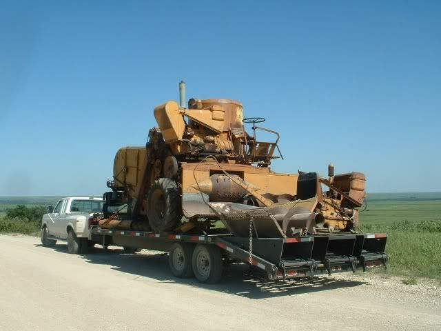

Here we are taking a little rest stop in the Flinthills of Kansas.On the trailer is a running model S MM combine that we hauled home from just west of Wichita,KS.
I would like to thank Curtis for selling me this nice combine and for helping us get in getting it loaded.Believe me there is no harder combine to load and to haul than an S MM.It was quite a job to get it all torn down.

1206,
awesome wow, totally cool,
How did you find this????? ???
Ohhh my gosh<<<<< and it has the spoke wheel's too, wowsie!
I cant believe this 1206, it's actually all there,and the other pic;s look rally good,
what year is this 1206?
gotta be late 40's, or 50, or 51?
I guess their out there if you know where to look and I cant beleve the header bat's , all there, with paint on them too,
wowsie!
IREALLY WANNA GHET MINE HOME NOW PRONTO,
1206, this one is Identical to my grandad;s , spoke wheel's and all,
1206<
maybe I should go with you next time i hunt combine's , cause you can sniff them out from a long way's away,
super nice find though, I wana see it when you put it together ok?
and ?
I wanna hear this thing on you tube if you wanna tape it which I think would be totally cool ,
I mean who's ever seen a rarew Minnie type S on video?
Keep in touch ok 1206?
and again, an Incredible find!

Great pictures, I'm surprised the drive wheels fit on the trailer, they must be the same width as my Unis are.

John,the drive wheels didnt fit.You cant see them but there are two 10 ft long 2" by 12" oak planks cross ways under the drive wheels.We had to plank it the entire way on the trailer.I dont know why MM built those combines so wide.Even with the wheels dished in,only about 3" of each tire fits on a 102" wide trailer.
In case anyone ever buys an S MM heres what has to be done to haul one.
1 Unloading auger has to be taken off.
2 Clean grain elevator has to be taken off and lowered to trailer floor to be under 13'6".
3 Operators ladder has to be removed and drive wheels have to be taken off and reversed.You need at least two 10 ft long heavy planks with you to put to safely load it and haul it.
4 Sickle has to be pulled.
5 Reel has to be pulled and two bats taken off to haul it without damaging it.The reel on this combine is like new.
6 The entire right side of the header has to be removed to narrow it down.Thats easier than trying to pull the entire header.
We have about half of another S MM on the trailer.A nice one was junked in the area where I got this one and the owner saved alot of it.Curtis let all this go with the combine.I also have a parts S MM combine so should be set.
