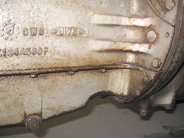

Okay, Let's give this a try..... This picture is of the oil pan I wrote about in my post below (Other lives of a Z129?). If anybody has an idea about what piece of equipment this was used on originally I'd like to hear it.

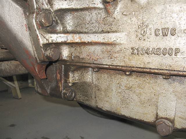

Melville Will
08-22-2007 10:42:53
Report to Moderator
 Re: Odd Oil Pan, TO-30 in reply to Melville Will, 08-21-2007 14:02:36
Dan S (NY) & greenbank,
Thank you both very much for your photos that prove without at doubt where my pan came from. The way the pan on a Z134 is bolted to the tractor at the front and rear makes it an actual structural component of the tractor. That added strength has got to be good for the block, and may go a long way toward explaining why I don�t seem to see as many posts about cracked Z134 blocks.

Dan S (NY)
08-22-2007 05:51:04
Report to Moderator
More pictures..this is from my MF50.

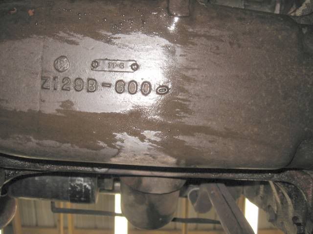

Melville Will
08-21-2007 23:12:38
Report to Moderator
Hi guys,
Well, I�d say the mystery is pretty much solved. But does the casting number on the bottom of your oil pan(s) read �Z129B�? It doesn�t break my heart to have a Z134 oil pan, as long as it fits. If it doesn�t, I'll have the first part for my next tractor!

greenbank
08-21-2007 23:44:35
Report to Moderator
 Re: Odd Oil Pan, TO-30 in reply to Melville Will, 08-21-2007 23:12:38
Yep, as I recall, Z129B-600, but I'd have to check.

greenbank
08-21-2007 20:37:26
Report to Moderator
third party image
It is a pan for a Z134. The front holes you were curious about are for two long bolts which go through the front axle extension, whatever the official name of that is. You can just see where that happens in the photo above.

greenbank
08-21-2007 16:15:54
Report to Moderator
That looks like the oil pan on my TO35, Z134 engine. I can go out and confirm that.
