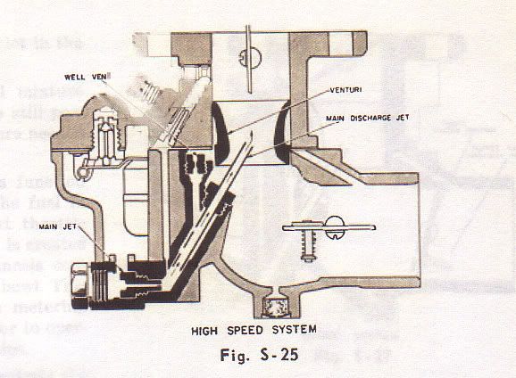

Hi CENTAUR - just reading through you post again, and I've got a couple of queries. I'm not at the tractor at the minute, so I can't look, but when I look at the carb, there are three adjustments I can see - the big screw under the float bowl - am I right in thinking this is the idle jet adjustment?
Above that there is an adjuster with a spring and a slotted head - is that the high speed adjuster?
And behing the neck of the carb, there is an adjuster that seems to be a throttle stop of some sort - how important is that setting?
And finally, I don't understand about the inlet screen at the entrance to the carb. As far as I can tell, the fuel pipe goes straight through to the float chamber, via the float cut off switch. Am I missing something?? The carb is a Zenith.
Thanks for your help, Matt

 Re: Zenith Diagram in reply to Matt Higgins, 06-12-2007 02:13:27
third party image
Upper Screw = Idle, Throttle Stop = Idle speed
