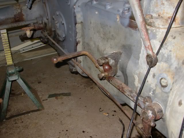

I just picked up a TE20 Massey Ferguson today and have a couple of questions. Everything looks very normal, except the transmission is made of cast aluminum. There are no stampings or markings on is except SM 3 on the side.
The other odd thing is that below where the clutch arm enters the left side of the transmission, there is a shaft that goes all the way through the transmission left and right that have pedals on each side to be operated by foot. On the right side, the pedal locks down similar to a parking brake, but these are not for the brakes as there are pedals for that going to the rear axle.
What type of transmission is this, and what does the left and right pedal do????? Is this a Sherman tranny or???
Any help is appreciated. Thanks. Jason.

To clarify my prior post, I have the right side brake pedal that when applied applies both brakes, what I don't have is the arm that attaches to the left side shaft, the arm that attaches on the outer right side shaft, the two shafts or rods that go back from the arms to the brake shafts, and the mounts the go from the brake rods to the actual brake shaft(that applies the brakes). Anyone have these parts?

Am I misunderstanding this, or do you mean you have two separate brake pedals mounted on each shaft at the rear axle ? This is normal, and is to be able to brake only one wheel at a time.
Then, do you mean you have 1 clutch pedal on the left side of the tractor, and then 1 more pedal on the left side, and then 1 pedal on the right side ?
This would be something I have never heard of. It is meant to be 1 pedal on the left side, and that is the clutch pedal. On the right side it is supposed to be 1 pedal too, and that is a brake pedal braking on both wheels at the same time and also working as a parking brake.
The cast aluminum you talk about in the transmission is actually a material they called "Electron".
Remember that this material easily is eaten up by corrosion.

I think you will find all the TE (Tractor Europe) series tractors had aluminum transmission casings. Only the TO (Tractor Overseas) series tractors had steel castings.
I suspect from your description you have a normal TE20 transmission - although I've never seen a TE20. I think you are referring to the clutch and brake pedals, both of which have shafts passing through the bell housing, one above the other.
You should also have two backwards facing differential (left and right) brake pedals.
Photo is the right side of my TEA20 transmission. You can see the "blank end of the clutch rod" above the "brake pedal rod".
You can just see the diff housing casting date in the diff housing, between the "port hole" and gear box flange.

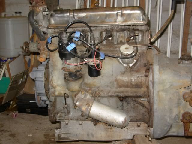

Note the oil filter and oil filler position on my engine. If the left side of your engine looks like mine and you have an aluminum casting transmission, it sounds like you have a TEA20. The Standard engine number is stamped into the block, immediately behind the coil and should start with "SC" (my engine number is SC52793E).
(The starter motor is out of my tractor during the rebuild. It mounts slightly above the small silver pin you can see through into the bell housing, which I am using to hold the engine at TDC on No 1 cylinder.)
If the engine is different, engine number starts with "Z120" and you have an aluminum casting transmission, it sounds like you have a TE20.
There was a good thread in this forum a week or two ago which had photos of both the Continental and Standard engines and highlighted the differences.

Oddity. If it has a Lucas distributor it must be a TEA20 with Standard engine. I think the Continental engine had a Delco distributor?
What engine do you have? The same as my engine in the photograph?
I would be extremely surprised if the starter or generator off a TE20 or TO20 would fit a TEA20. And the starters fitted to a 6 volt TEA20 is very different to the starter fitted to a 12 volt TEA20.....

The engine is a continental as it has the oil filler tube on the left front and has a Z120 cast into the block. The dist does say lucas though.
