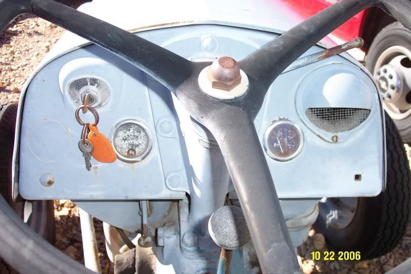

I just happened to notice today that my TO-30 has a punch out area on the dash for a third gauge. Yours has the third hole ready for a gauge. What gauge goes there? My dash has an ammeter and an oil pressure gauge.

Your gauges look just mine on the 35 , neglected. The 35 has a temp gauge as well

I knocked the punch hole out so I could put a water temp guage in.
Cheap insurance against it over heating and cracking another block. (tractor came cracked) I paid $600 for one already and dont wanna have to find another or have mine fixed.
