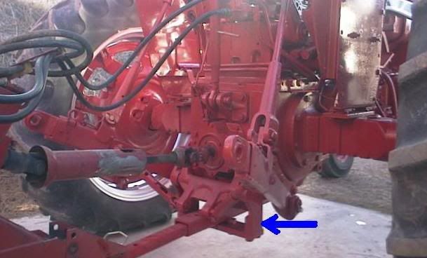

Does the front end of the 656 drawbar mount to the underside of the trans case similar to how a M drawbar mounts???
If so maybe something like this may work. I don't know how much tounge weight ya might be needing to deal with, BUT

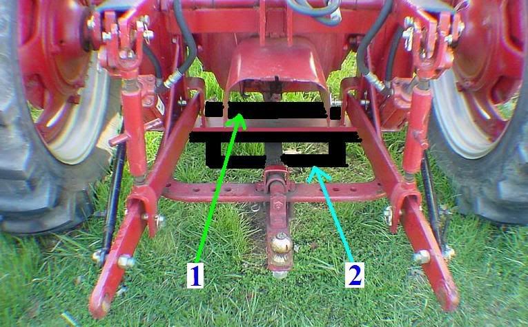

Maybe ya could get the lower peice of a 656 Drawbar from a salvage yard, and make something up to do what ya want. If ya can get this 656 bracket assembly:
Ya might be able to take a peice of 1/2" x 4" X (? lenght) angle iron and weld it to the frontside (foward of the PT0) onto the flat bar that is now on the saginaw assembly. Then make up a mount to hold the 656 part from the salvage yard.
If ya think it might not be heavy enough, weld a 1/2" X 2" X (? lenght) peice of angle to the upper rear side of the flat bar for extra support???
#1 would be the angle iron, and #2 the bracket part from a 656 drawbar.
Just thinking out loud, BUT that has been known to cause me a lot of work lately.

Allan In NE
03-07-2008 05:58:10
Report to Moderator
 Re: Hey Allan In NE, that drawbar ya want to use ??? in reply to gots-2-go, 03-07-2008 05:29:38
The telescoping type uses a 'double drop' with a different bolt pattern at the tug bolster to clear the rearend. That's gonna be a problem.
So, now I'm back to figuring out how to adapt a 1" standard drawbar, which has the needed bends.
Anything to get rid of that swinging drawbar. IH's biggest waste of iron ever in my view.
