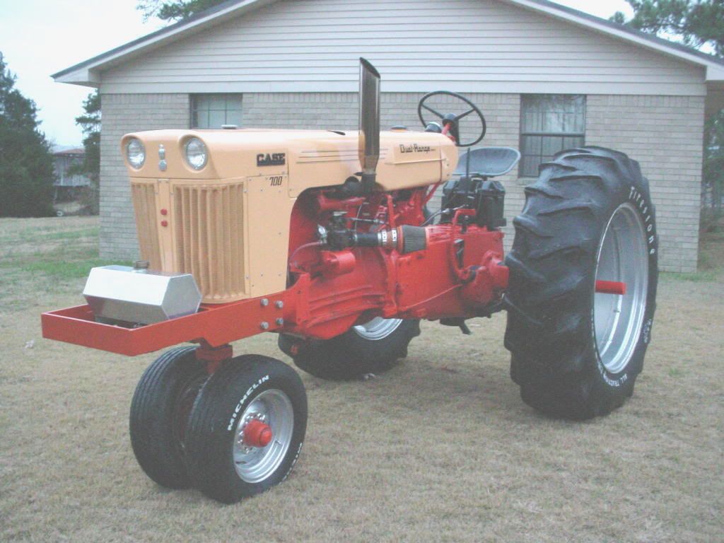

Picture of it
12-16-2005 19:07:41
Report to Moderator
 Re: 400 stroke in reply to Benj, 12-15-2005 09:41:33
third party image
It's almost finished. Just a few minor additions to go.

 Re: 400 stroke in reply to Picture of it, 12-16-2005 19:07:41
Dang that looks good. How does she pull? It looks like you have new front grille screens or are they just good original ones? Did you make the hood? I cant for the life of me figure out what it is off of. Are those 18.4X34s or 38s on the back? What kind of hubs did you use. I can't find the right size hubs.

 Re: 400 stroke in reply to Benj, 12-16-2005 19:47:14
third party image
Send me your email. I'll send you some more pic's. The tires are 18.4 x 38. It is an original hood from an 800 Case. Grill screens are the original one. A friend of mine straightened them BY HAND. I think his fingers are made of steel. I've only had it to 6 pulls so I haven't figured it out yet. It pulls pretty good though. I just need to get used to it. I've pulled 4th gear up though 7500 lbs. and never lost power. Usually spins out on about 1700 rpm. Ain't bad for an old homemade rig. Email me.
