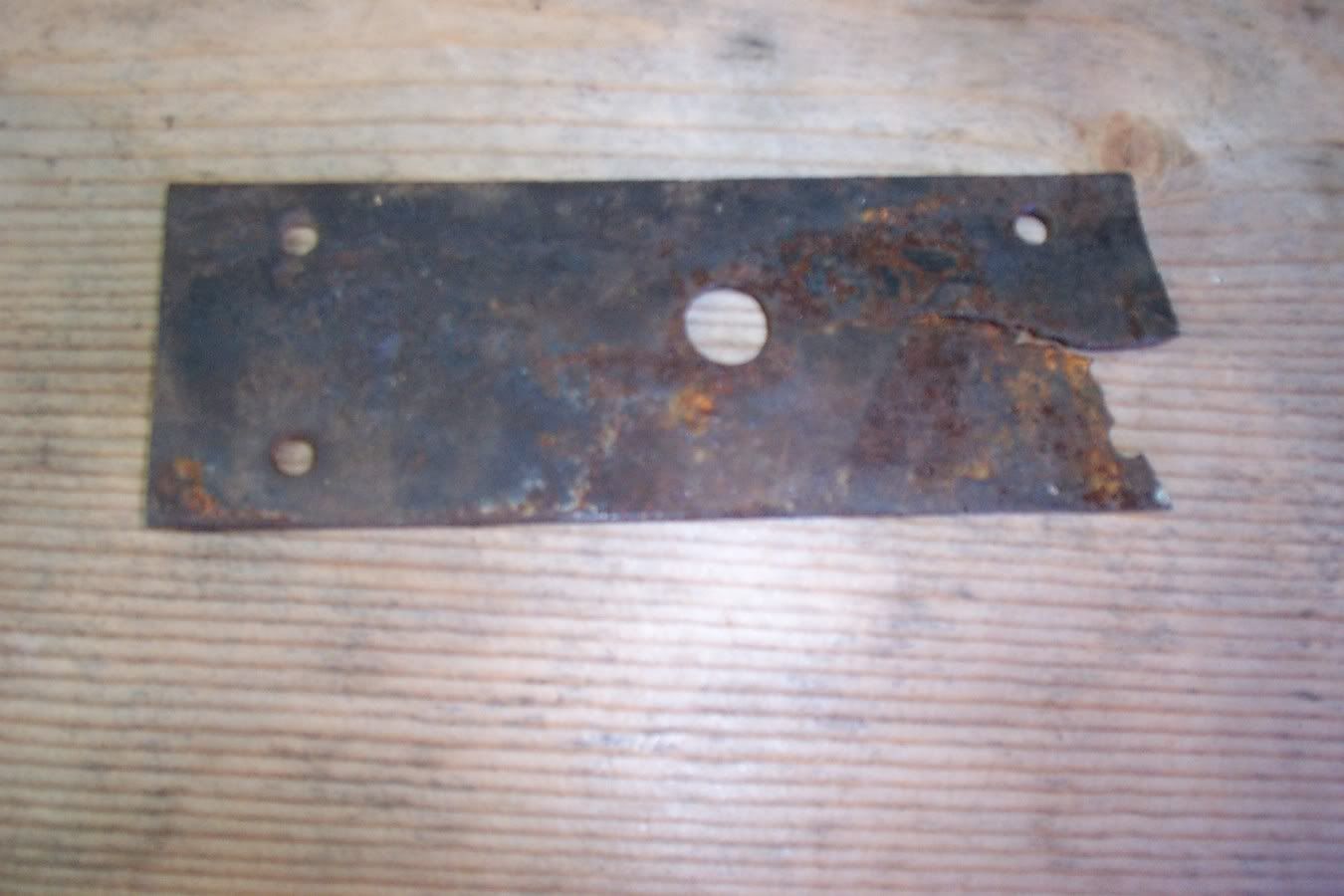

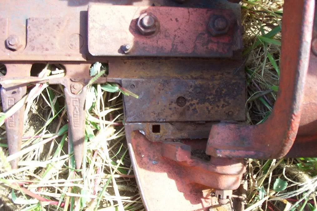

Here are a couple pics one shows the piece that is giveing me grief and one shows where this troublemakeing piece fits on the mowers. I sure would like to get these fixed soon. Case no longer has this item I was told.... Link http://i3.photobucket.com/albums/y52/Forsythia-man/DCP_1920.jpg

R Wyler,
That looks exactly like the one I had replaced on my New Holland 47 mower. I just made one to fit out of a piece of cold rolled plate. Just watch to see that you get the proper thickness, too thick will make things bind up.
The part # for the Ledger Plate on my mower is 39651 if you want to call a New Holland dealer to see if it will fit your rig.

 Re: Pics of my sickle mower delima in reply to KirkMn, 09-21-2005 06:52:18
Thanks for the info. Anything is possible maybe I could make a NH one fit. I will remember that.

That looks like a plain flat piece of iron. Would it be possible to just have one made? You have the old one for a pattern, just drill new holes and away you go! looks like apretty simple thing to make. You don't even need a fancy shop. A simple drill will get the job done. Why spend a bunch of time and money looking for a new part when it would be easy to make your own!

 Re: Pics of my sickle mower delima in reply to Amanda Rekonwitt, 09-21-2005 04:48:35
Yes I have thought about it and it may very well come to that.

IF HE DOES NOT HAVE THE PLATE'S YOU NEED YOU CAN SEND ME THE ONE PEACE YOU NEED MADE. I CAN FABERCATE IT FOR YOU. I HAVE DONE IT TO MINE AND YOU CAN NOT TELL THE DIFFERENCE.

 Re: Another pic in reply to WALTER, 09-21-2005 20:44:23
Thanks Walter I may take the one off my other mower and send it to you if you would like to make me another one. Do you know where I can get those special rivets or can you tell me the size of them? My email is [email protected]
