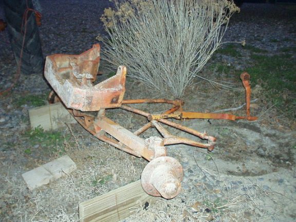

Sounds like someone changed the non-adjustable wide front (NAWF) for a narrow front (NF) sometime in the past. If you buy the tractor and want it to be a NAWF as it came from the factory I will trade you a NAWF setup for your NF.

I would be curious as to what you think the year of your wide front is? Compared the the NA wide front on my '48 there are differences in the front casting, there is extra bracing under the axel, the tie rods are ball joints , not a clevis and pin like mine and the steering rod has a "offet" section in it.
I'll make a bet that the front end in the picture is off a VAI that had a front-end loader on it.

Possible BUT I know of an original '47 VAI that has an un-gusseted axle....maybe the answer is 'lost in time'? As to what year I think mine is?....just don't know.
