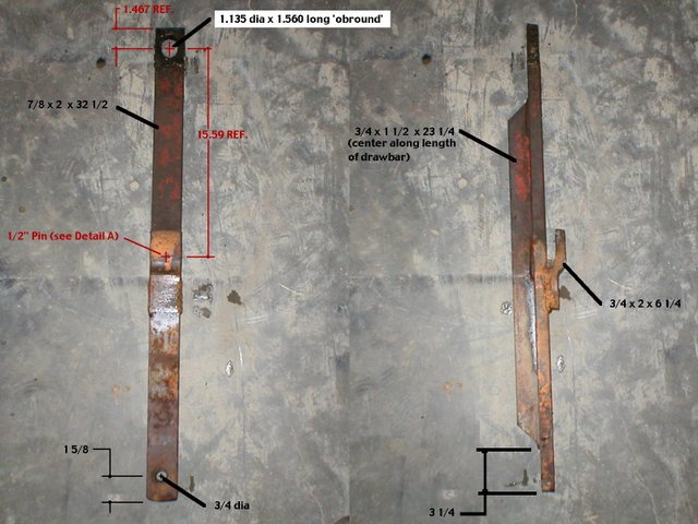

DOES ANYONE HAVE A PICTURE OF THE DRAWBAR ON A VAC. MY CAME WITHOUT ONE SOMEONE TOOK IT OFF FOR A BELLY MOWER.

Well mj, I appreciate the considerable effort you put into the drawbar pix. I don�t need a drawbar now but who knows maybe some day. I moved it into my �good to know� tractor files.

third party image
Here's the first one...click the link for the whole deal. They are images 33 & 34....click on one to enlarge.

I've got to switch a drawbar from one tractor to another tomorrow so I'll get you a photo while it's off and some dimensions as well.
