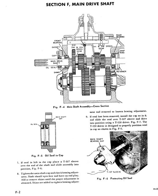

My neighbor got his gear shift assembly but says that he can not get it to go back in properly , says all looks good inside and all the gears slide back and forth , is there a proper sequence to the gears so that all will work as is suppose to ?

 Re: Vac 12 tranny in reply to Carlton, 01-19-2005 18:28:48
third party image
Click on the link for more info.
