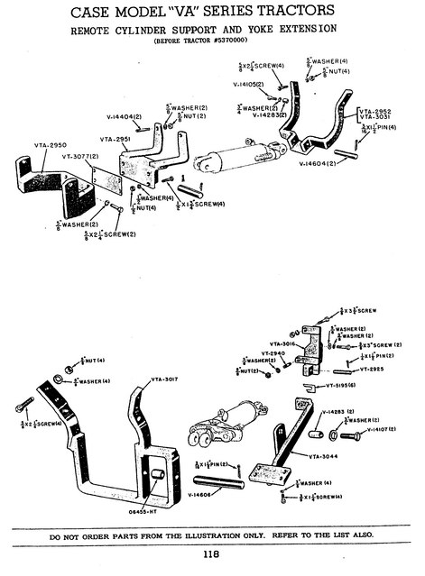

I am trying to find a hydraulic pump and have been contacted by two guys who have pumps for my tractor. I am trying to figure out which is the correct one. One mounts between the engine and transmission on the pulley shaft and is operated by cams on the shaft, therefore the clutch must be engaged to operate the pump; the other mounts on the front of the engine and engages the timing gear, so would operate whenever the engine is running and I suppose must have some sort of bypass system. My tractor appears to be setup for use with the rear mount pump, but has a removable cover for the front mount. Does anyone have experience with both who could offer me some advice on this issue?

mj
08-01-2004 08:54:10
Report to Moderator
 Re: 48 VAC Hydraulic Pump in reply to Wilson, 07-31-2004 16:53:03
third party image
I agree that the live pump is, as you say, more desirable as it is live and has 3 times the volume of the belt pully pump BUT it produces less than 1/2 the pressure (900 psi versus 2000 psi) SO the original lift capacity of the midmount lift will be approx. 50% of original. Since Dustin is wanting at this point to return the tractor to original he needs the hi-pressure pump. If he decides that he needs the live pump he could add it later and even run both pumps as separate systems with the addition of a live pump, valve, lines, etc. That way, the hitch would run off of the mid-mount and a loader or whatever would use the live pump. IF the pieces could be found or replicated he could add the live pump and convert the entire setup to a version of the CASE add-on kits shown. ...Or he could use a live pump and obtain an Eagle hitch rockshaft assembly and mount it to the early rear casting as shown on the link. If he chose one of the latter the tractor would still be vintage in that he added a system that was available during the VA Series production run....at least that's the way I see it.
