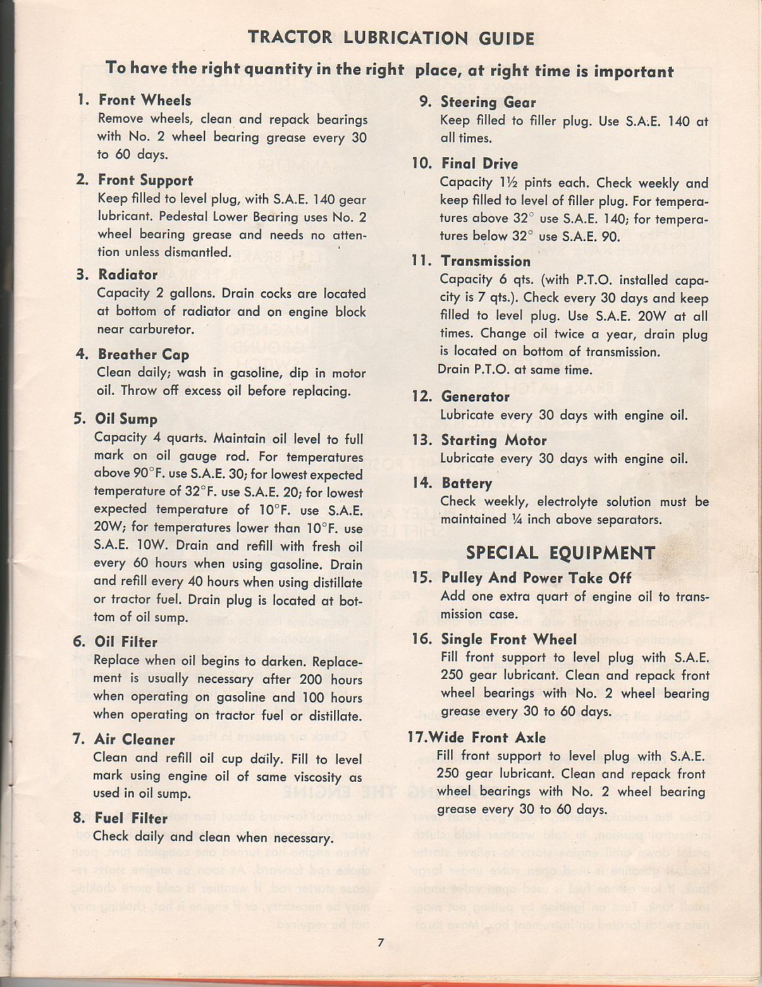

Howdy everyone! I just purchased a 1952 AC B. I'm ordering a service manual, but in the meantime, I'd like to change the oil. What type and how much oil does this tractor require? Thanks in advance.

Dick L
06-30-2006 19:27:21
Report to Moderator
 Until You Get Your Manual in reply to malamute, 06-30-2006 15:42:21
Peek at this page.
Have fun with your new toy.
third party image
[Log in to Reply]  [No Email]

I like 10w30 motor oil. use th eC159 FRAM filter. the transmission, differential and bevel gear are all the same cavity. there are 3 of 1/2 inch pipe plugs on the bottom. fill with 8 quarts of universal hydraulic transmission fluid thru the 1 inch pipe plug on the left side of transmisison by your foot.--- dont forget the final drives, inside the tire rim there is a sheetmetal half moon pan. pull each and clean, then add a quart of 80-90 gear lube.
