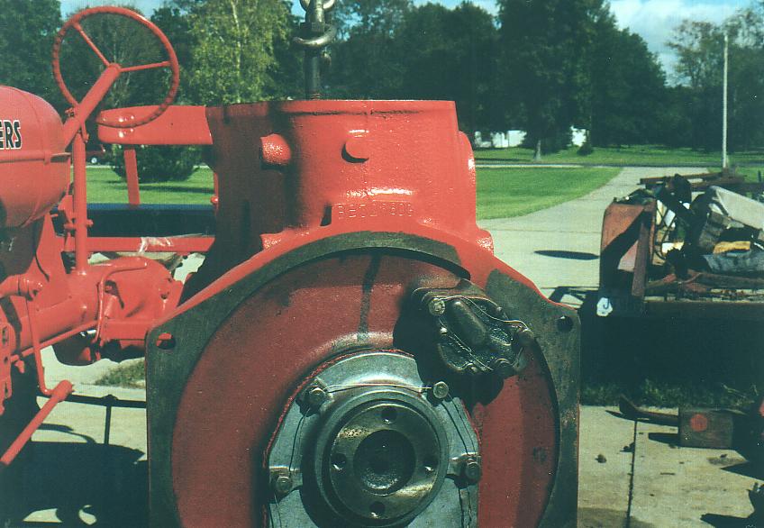

This is where the engine number is located on my 1940 B.

should be on the flat machined area where it bolts to the fly wheel housing. should be BE or CE and a 5-6 digit number. BE is the original 3-1/4 bore, CE is the later 3-3/8 inch bore.

Should be stamped on the left side of the block somewhere rearward from the carburator.
