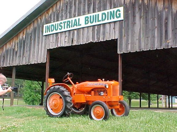

It would be a job to restore thats for sure! I sold a complete but needed a lot of work IB for $1000 a couple years ago. I bought the one I have restored for $5000 about 4 years ago. I know of a decent one that was unrestored but runs good brought $3600. If it was me and if you were not interested in it I would let the fine fols here know about it so they can try to get it bought. By the way the front axle is correct!
