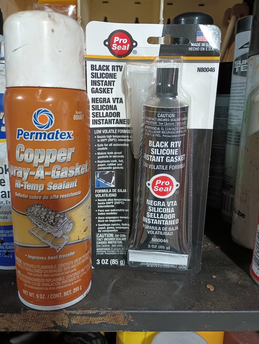

We buy this set from Napa and Amazon. Includes several other gaskets. Around $30.
We have done a few! Chase all the threads, copper coat the gasket, and a little black goo in the threads. We have never had an issue.
