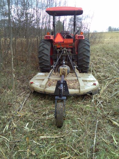

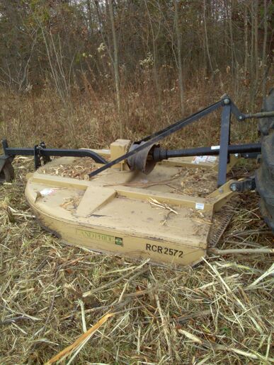

Here are some pics of a 62 PTO HP tractor (Kubota M6800) running a 6' Land Pride RC. No power problems here but in cutting heavy 5' high grass the tractor's low gear was too fast to keep the mower from clogging and slipping the mower's clutch. Just took a half swath to keep that from happening. I think a slower gear (creeper) would have helped. Before this I was using a 70 year old WD Allis Chalmers that had probably 25-27 PTO HP and it proved somewhat challenging but got the job done mostly because that tractor, while also having a too fast 1st gear had that magnificent hand clutch that could be slipped when necessary. Also that tractor's front end was a little bit light but manageable.
