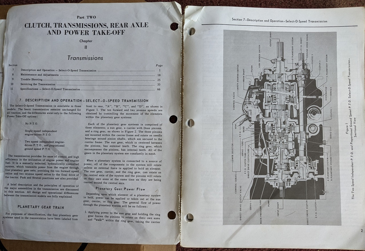

If, after evaluation, you decide to tackle the SOS, you will need the manual. The SOS supplement was included in my 1954-1964 Ford Tractor Service Manual but is also available as a standalone on Ebay and other places. Below is a sample of the title page and troubleshooting chart. It runs around 69 pages. With SOS you must think like a technician.
