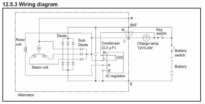

All alternators I have worked on have a fuse or fuse link between the output stud and the battery. The diagram I attach is as close as I can get (assuming it is a Hitachi)
The post should have 12v positive. The other wires are as shown (assuming) Jim
