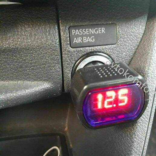

Check your system voltage. My F250 was doing that and it turned out the voltage regulator was very intermittent on how much voltage it would make. I put a volt meter in the power port and found it.
