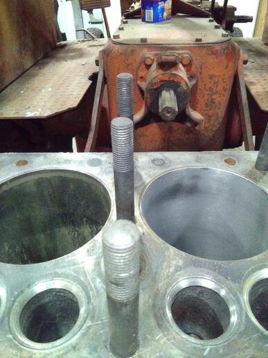

I think this is the point at which Fritz suggests you stop honing. I used a 3 stone spring hone, 240 grit so the cross hatching is faint. It's also not the 45 degrees that is suggested by many. I'll have to work on my speed and rhythm. I used a ridge reamer to take the ridge out before I removed the pistons. The other cylinder is so far untouched, No rust or pits. The hone came off eBay, for about $30 used and virtually brand new. Good luck Andrew. steve
