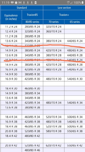

Re: What tire is same as 420/70/24 ?
Posted by NDIHC on September 24, 2023 at 09:29:26 from (174.213.162.21):
In Reply to: What tire is same as 420/70/24 ? posted by Garrettohio on September 24, 2023 at 06:43:34:
This chart shows it as a 14.9-24. This chart only shows radial tire sizes but non radial would be the same, just without the ''R'' in the size.
