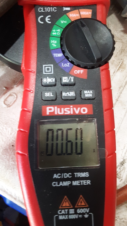

Just wondering if ya'll have a suggestion.
My suggestion is to buy a cheapie clamp-on DC ammeter to find the problem.
Fuses blow because of excessive current or excessive temperatures. A bad fuse holder will get hot and blow fuses. An IR thermometer can tell you which wire or if the fuse holder is hot.
Amazon sells this cheapie meter for around $30.
I'm impressed with its accuracy.
Or you could use a 30 amp fuse and wait for something to get hot. It will let the smoke out of the wire. A good idea to carry wire cutters and a fire extinguisher if you use a 30 amp fuse.
