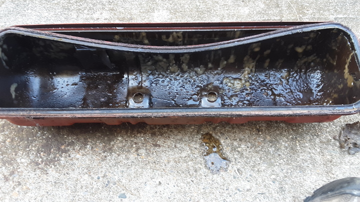

This is my second sticky valve.
One was on my 20 hp kohler command 2 years ago.
This is my second sticky valve on the Jubilee.
Both Tractors don't see a lot of work anymore.
Count your blessings.
See the water inside the valve cover and on the
concrete.
There is a vent next to where the water is.
Vent allows moisture to get trapped under the
valve cover. There is also a vent at the filler
cap.
I'm closing off the valve cover vent and
installing a PVC valve.
What's the worst can happen? More sticky valves?
