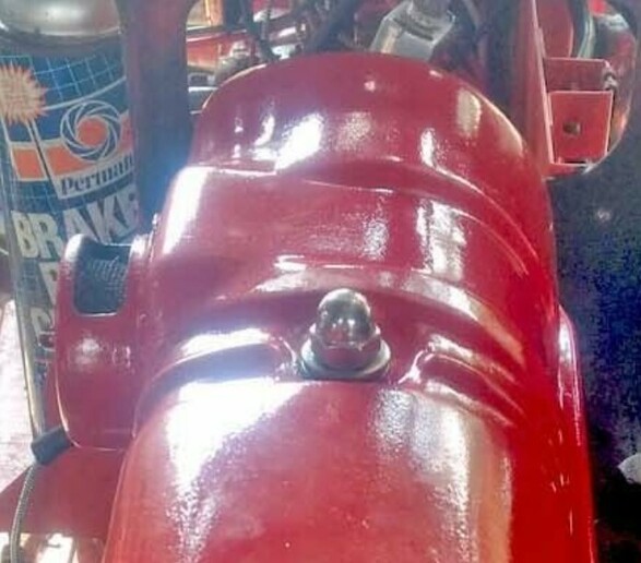

Yours has the vent on the side of the valve cover like this one.
You could indeed add a PCV (stands for Positive Crankcase Ventilation).
You will likely need to but a cap over that side vent or block the space where you can see the mesh inside.
Might remove that mesh all together when you have the PCV hooked up.
I think the PCV also needs to be installed vertical?
