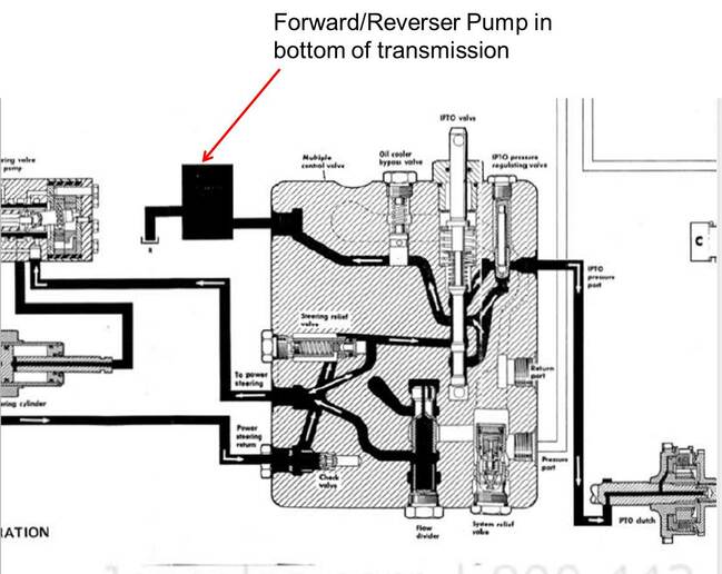

Re: International 574 Hydraulic problem - Suspect new pump
Posted by JimB2 on September 22, 2023 at 11:09:40 from (174.114.155.238):
In Reply to: International 574 Hydraulic problem - Suspect new pump posted by RW-IH574 on September 22, 2023 at 00:30:19:
See below for photo of IH 54-74 Series MCV valve, your 574 probably doesn't have the FWD/REV option in the upper left corn and that hydraulic port will go to the oil cooler in front of the radiator.
