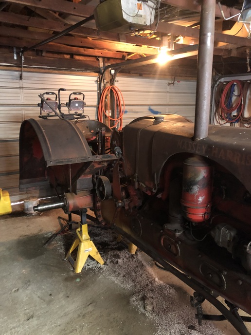

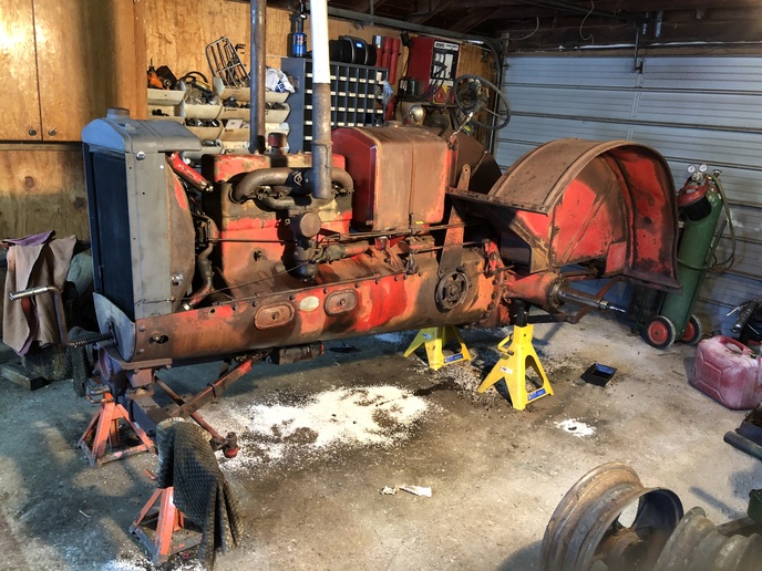

Nothing too difficult on the mechanical restoration. Axle seals and some gaskets to fix a few leaks. Removing the oil pump to clean it and check it out was the most difficult. I took it off and out through one of the inspection covers so it was a tight fit with my big hands. Flushing the oil lines and cleaning the crankcase was messy and took some time. I forget what the compression numbers where but they where even and good so no engine work was done except adjusting the valves. Lots of hours spent doing little things but very worth while.
