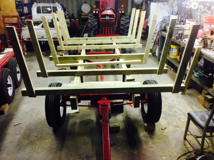

Here is a photo during construction. No plans. $1600 at Menards in 2016!
Carriage bolts on the uprights. Angle iron and lag screws on the cross members. 2 ball hitch. Fully lighted with led lights and multiple reflectors. Goes to three elementary schools for AG Day every year. Multiple family, church, and sports team rides. 1000s of riders! Send me more details if you need them.
