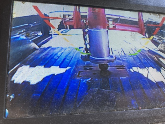

This is how I hook up my trailer to haul the Oliver 1550 to shows and tractor rides. I painted a line down the center rib of the box lining up with the ball.
I use a cheap backup camera plugged into the lighter and a plate on the tool box and a magnet glued on to the camera.
I painted the hitch on the trailer white. I watch the camera and back up lining up the line in the bed with the hitch, the trick is stopping with the ball in line with the hitch.

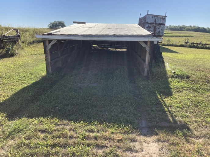

I got 2 hog sheds from the neighbor that quit raising hogs and park the trailer in them
It keeps the tires out of the sun, just have to leave it out far enough to turn the crank to unhook the trailer.
