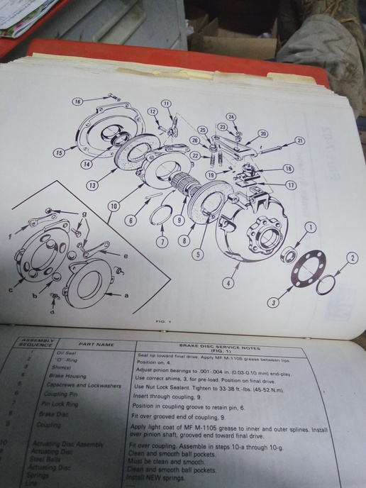

Re: Massey Ferguson 550 Combine Brake Problems
Posted by mtf on September 04, 2023 at 08:17:29 from (66.38.105.22):
In Reply to: Re: Massey Ferguson 550 Combine Brake Problems posted by mtf on September 03, 2023 at 17:03:44:
Here are some pages in my service manual.
