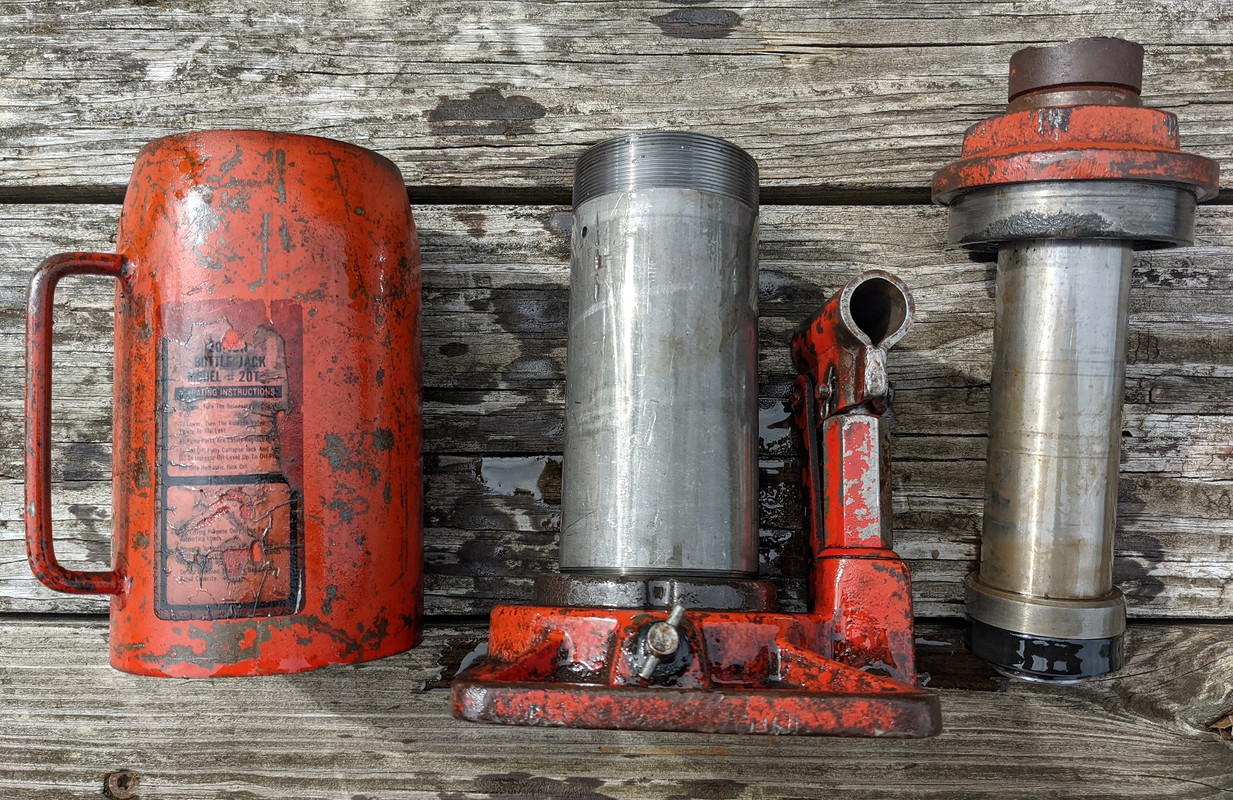

You can take them apart and try to fix them. However new ones are so cheap that
it doesn't make sense unless you are curious/stubborn/sentimental etc. Look for
seals/kits on eBay, the Web etc.
Below is an old one I took apart recently. Label says ''All Pump Parts are
Easily replaceable''. However rod and bore dimensions were odd and I couldn't
find a main seal no matter how hard I looked. Actually main seal still looked
O.K. and wasn't overly hardened. The jack acted like yours - wouldn't lift a
load. Problem wasn't fluid level, did the same thing when filled to spec. I used
common tractor trans-hydraulic fluid I see no reason that shouldn't work.
Problem might be check valve, release valve, pump seal etc., maybe later I will
fool with it some more.
