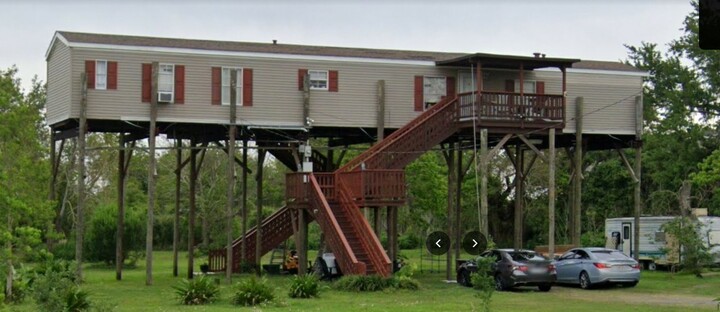

Around here in flood prone areas they take a house built on the ground and drive telephone type post down both sides.
They then jack up the entire house 10 to 15 feet in the air and connect the post with joist to sit the house on.
They do the same thing with mobile homes.
Lots of mobile homes 15 to 20 feet in the air around here.
