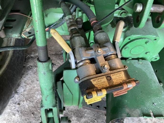

Ill answer your other question. Olivers have constant
pressure on the remotes , you need couplers that you can
release pressure to connect and disconnect hoses.
Shutting the tractor off and wiggling the levers doesnt
relieve the pressure.
