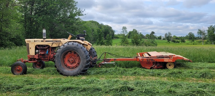

A 9' haybine can be run by as little as 35hp if it's an older heavy tractor like a formal H, but 50-80 is much better. My 70hp case 830 handles my 9' case haybine real well.
They don't take so much hp, but they need to bo heavy enough not to be pushed around by the mower. A 12' swing tongue will need more like 70-100hp for the same reason, they are heavier so they take a heavier tractor. Disc type take more hp to run.
