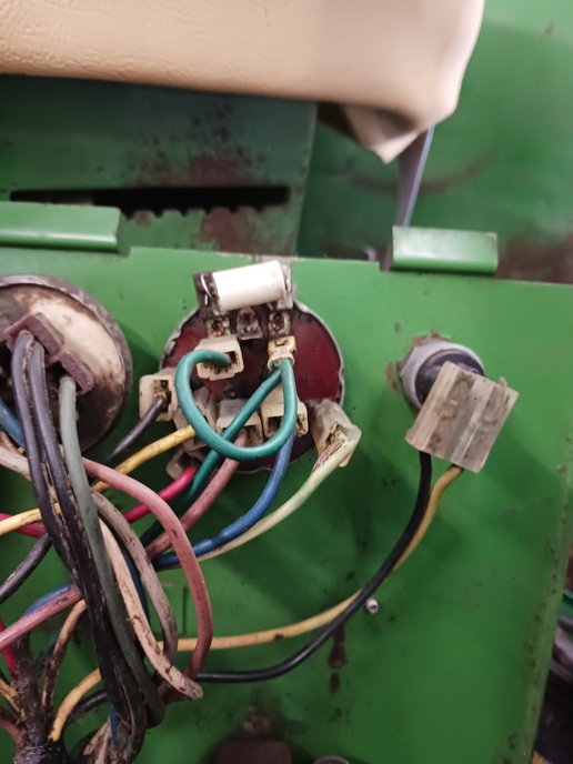

Someday I might install a light bar, but
am going to wait and see how much I even
use the lights. The original system will
get me through for now. Im going to
replace the light switch. There seems to
be a problem at hd2. That one sends power
through that spring. I have power until
any load is applied. Whether that be the
original circuit or a jumper wire with a
single light on it. Could you guys advise
what switch I need. I see there are lots
of options.
