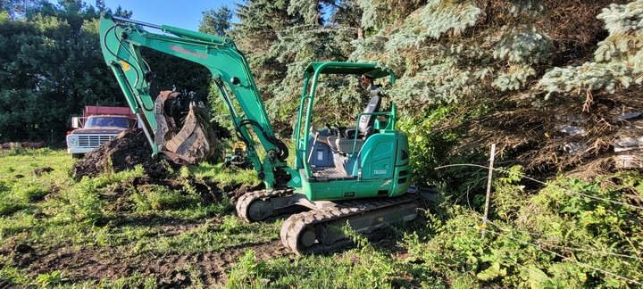

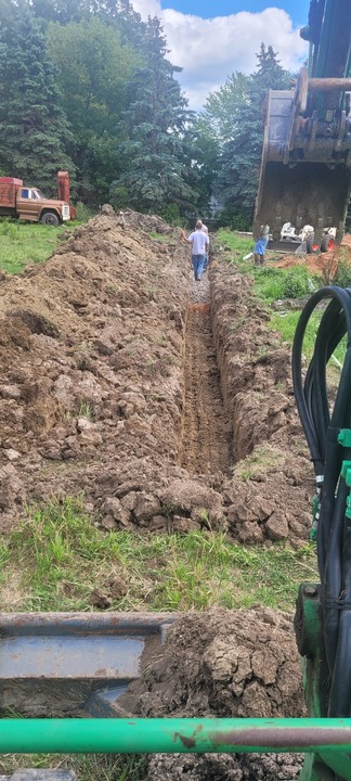

Spent the weekend digging holes. Rented
this mini hoe to work on the sewer that
wasn't working anymore.

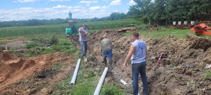

My sewer has been trouble since I bought the place, and they say for long before that too. So I just decided to run a new line rather than try to find the issue with the old one. Had some help from my son Eric, son-in-law Joe, and my friend Doug.

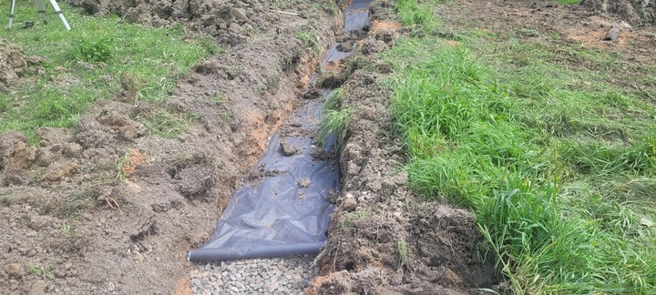

Dug in a total of 175' with a foot of sand and a foot of rock under, covered with rock and fabric.

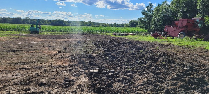

All done. Will have to run over it with a drag when the clay dries out and break down some clumps and smooth it some, but that's it for now.

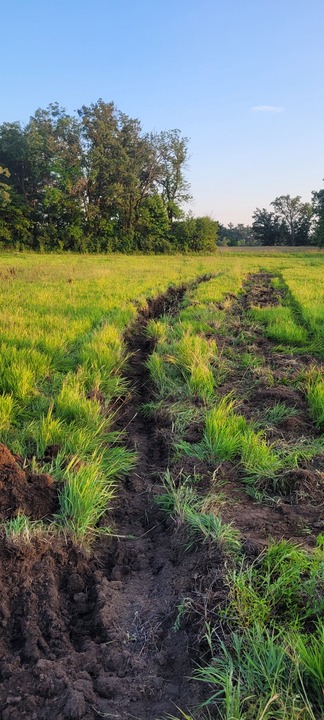

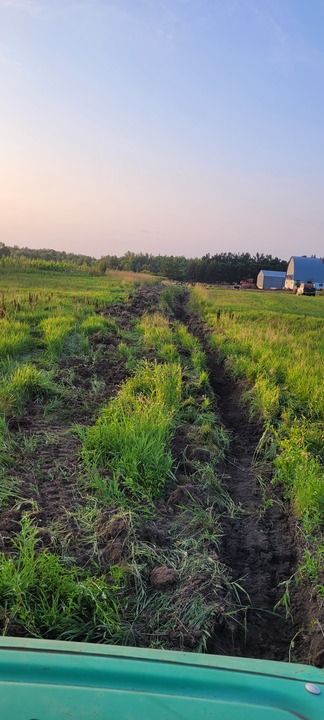

This is the finished job. This first pic is the start, the lowered culvert is at the far end. That's Bonnie, my helper for the day. She ran the Lazer.
This is the far end where I Y'd off to go across a field to get the wet spot at he far side. Didn't look like much of a hill, but I had to get 3' deep at one point.
I will work it down with a disc and drag and use the back blade to level it more and dress the sides up and spread the dirt out more. But hopefully I'll have more ground that doesn't drown now.
