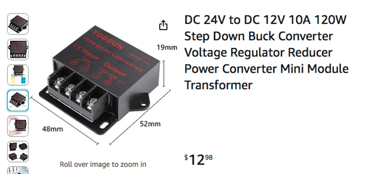

How many amps do you need for your application? I use these when installing 12VDC accessories into 24VDC heavy equipment. It is not good to use unconventional or non-standard wiring methods on things. A few years down the road, we forget what we did which makes it difficult to trouble shoot issues. ALSO, if someone else has to work on your stuff down the road, it can be a nightmare. I have run into some crazy work-a-rounds for various issues.
John
