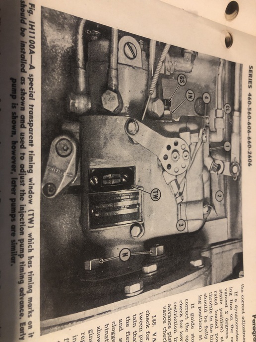

here u go, i dont feel typing a book. and yes it is very possible your timing is retarded, which will cause hot running. it has to be set at
3 degree's. here is your info. so get your mechanic to check it for you.i have seen people time these tractors by ear also , ... but that is
not what you do.
its very easy to check the timing, set the front pully on 3 degree's in engine rotation on the compression stroke, then remove the little timing window on the pump and have a look see at the 2 marks they must be lined up. if not loosed the 2 pump bolts and turn pump till they line up. done.
