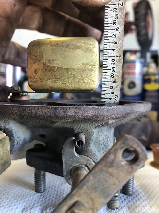

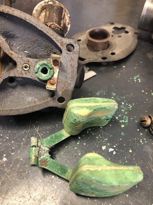

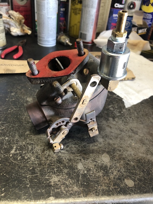

just showing what old gas does , and also how to check the float as some ask here. just a couple pointers. its off the neighbors 200
sa welder with the 4 cyl. continental. marvel schebler carb. all i had to do is make the intake gasket. very seldom do i buy carb kits.
