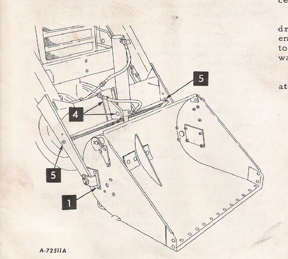

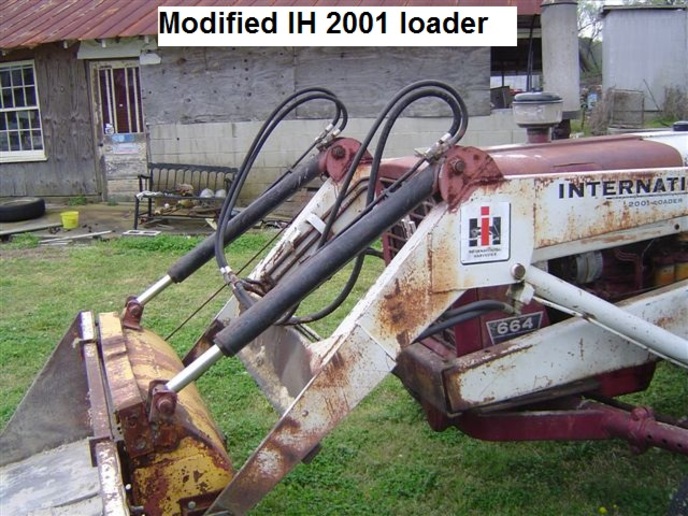

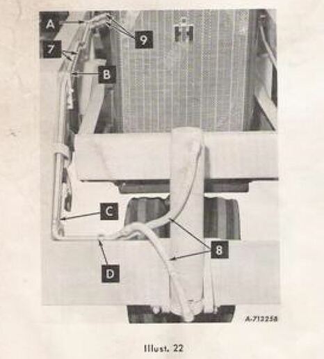

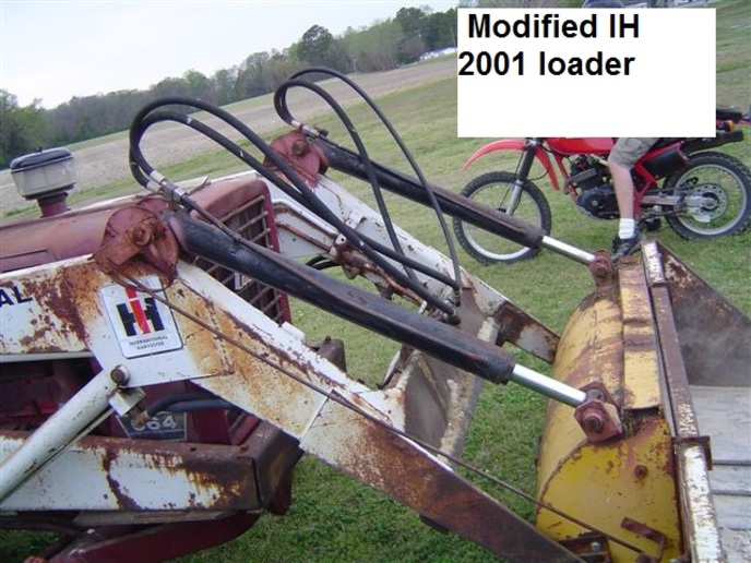

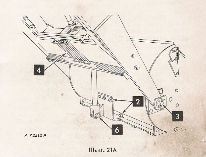

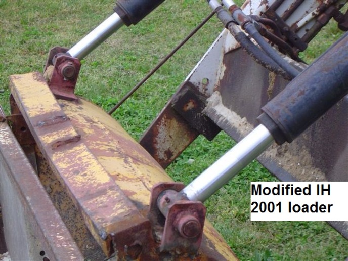

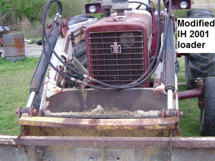

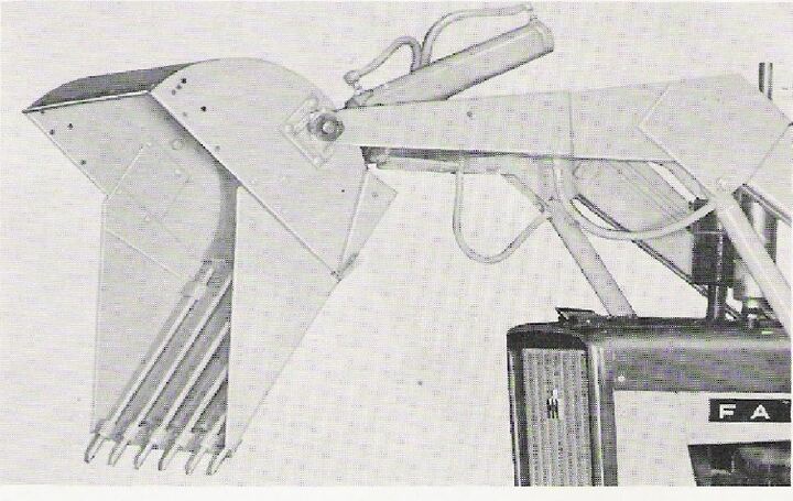

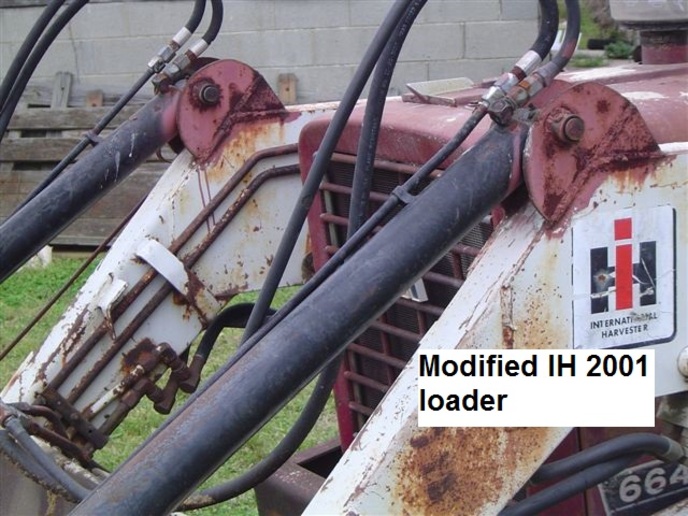

So, you do not have the original or any bucket for the loader nor the cylinder also? If you have no bucket, I would take the loader to a good welder and have it converted to be like a 2000 loader lift arm and bucket pivot points. Then you could put a wider bucket on it (available from many aftermarket sources) with two dump cylinders (available from many sources also) similar to the 2000 loader. Some pictures below from operator manual and pictures I saw on internet of a 2001 loader with original type bucket converted to two dump cylinders. The bucket pivot points and pins have no provision for lubrication. If the 2001 lift arms were modified to be like a 2000 then you could have greasable pivot points.
