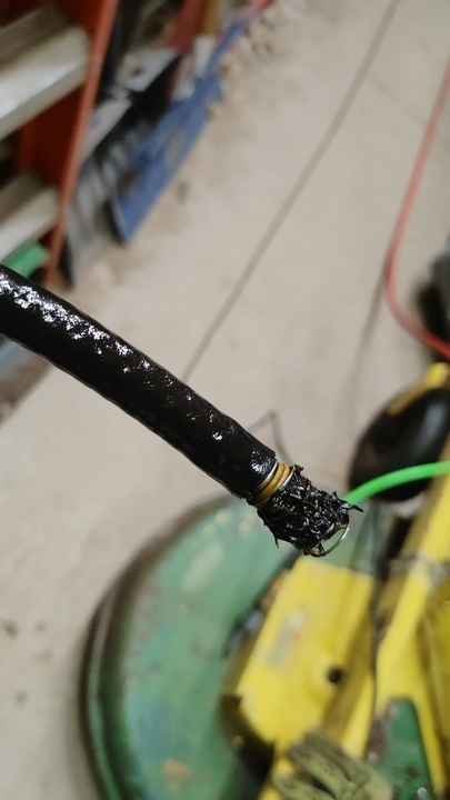

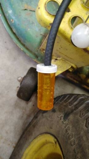

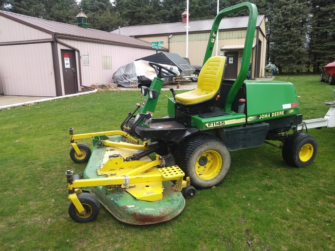

Different animal, but, my 1145 was doing that last year. It had dual tanks and lines with a separator valve. Figured the problem had to be something other than the tanks. Ended up being the tiny screens on the end of the suction ins in each tank. Who would figure they would both act up at the same time? Mine was definitely running out of fuel as the filter would fill with air. A quick bleed would gain be another 20 min. Try blowing air back into the tank and see if it clears up. Last picture is my {more permanent} solution.
