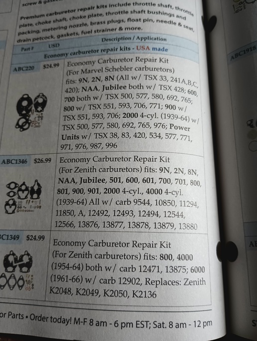

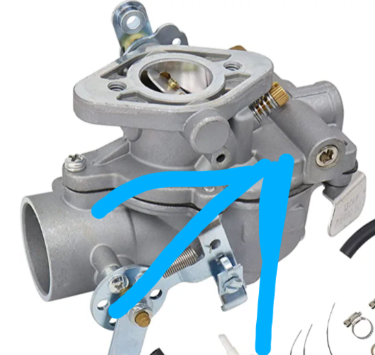

Should be a round brass tag with the number, if not some have it engraved on this flat spot. It appears one kit fits many carbs.
Zenith carb will be just fine on the N
